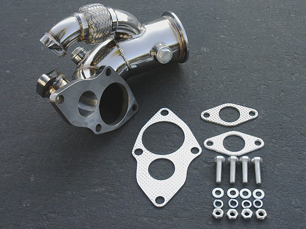

    What i was getting at was you can mount your wastegate like this
    http://www.boombopracing.com/ebay/pi...tdp-dsm4-1.jpg
    Means not having to screw with the manifold at all. You also wont have to weld up the wastegate hole. Its easy enough to knock one up too.
    That looks awesome, however Ive got a replacement manifold for a good price and the welding work was done by Spec2. So I still have my OEM manifold if I want to revert back
    I may do that in the future.

    Ive been looking into what to do with my internal wastegate, not really keen on having to weld things if I want to sell it or revert back, so will make up a bracket with a threaded rod
    much like this

    Wastegate will be a genuine Tial 38mm item, blue top to match everything else in the bay.

    Not to put a downer on things i will be very supriesed if that manifold works. The wastegate port is in the wrong place.
    where should it be? I cant think of anywhere else for the port to be placed, it sits above all 4 runners, the previous owner said it worked fine, was sold due to a new turbo/manifold setup.Ive been in other evos, both 5 6 and 7 with a manifold setup just the same as this and they all work fine.

    its definitely in the right place. my manifold on my gsr looked exactly the same and worked perfectly

    Its not ideal but it will still work IMO

    I'm sure it will work fine as hes not going for 800whp...
    Still doesnt mean its the right place tho lol.
    It should work fine, as long as your not expecting to hold low boost levels without spiking. Sub 10psi etc.

    i read on mmc that it's meant to come off the middle of the manifold at a about a 90 degree angle for twin scroll turbos so it looks right. I know of another evo 5 that is running the exact same manifold design with no issues

    how else is it supposed to be mounted?
    Not keen on having to spend a huge amount on a custom dump pipe-mount off oem wastegate port thing like Built4Speed posted at the top of the page and no point in a a baller manifold because im only using the OEM turbo so no need.
