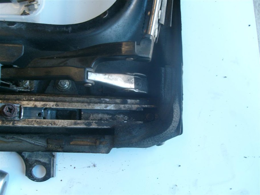

Turn the pan over. Remove the seal around the front of the sunroof. We are going to start by loosening the outer track.
Loosen the outer track by undoing this nut on both sides (bottom right)
And this screw on both sides
Pull the outer track upwards slightly on both sides:
